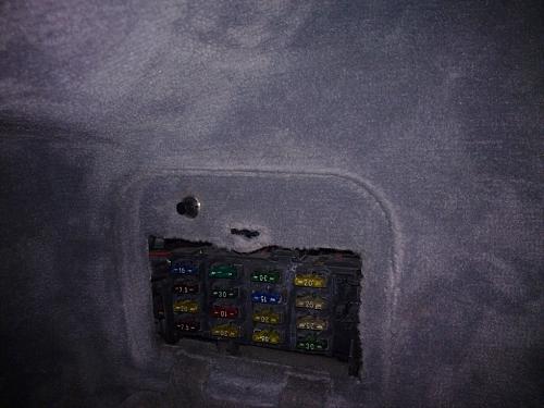

Iemand kreeg m niet gesynchroniseerd:
I found it. Turns out to reset my antitheft system, there is a black button just above my fuses in the boot. Press the button and press the fob button (while pointing it at the boot IR receiver) at the same time. Done
Om een lang verhaal kort te maken:
They CANNOT be reprogrammed!!! The circuits are pre-burned at the factory, and all the dealer does is sync the key WITH HTE CORRECT PRE-PROGRAMMING to the car! (same process as when the batteries go dead). That's why the dealership has to order them and can't just stock some generics to "burn"... these aren't CD-R's! I tried for a couple years to get around this after running two keys through the washing machine - ruining the circuit. The manual key blade still works, but once and for all: YOU CANNOT REPROGRAM A W140 KEY! Any eBay or person who tells you otherwise is scamming you! You can get a posser case and look all fancy, but they won't work remotely.

Ik zou nog kunnen proberen alle zekeringen van de infrarood eruit te halen en opnieuw erin. Dan wordt de infrarood gereset.
